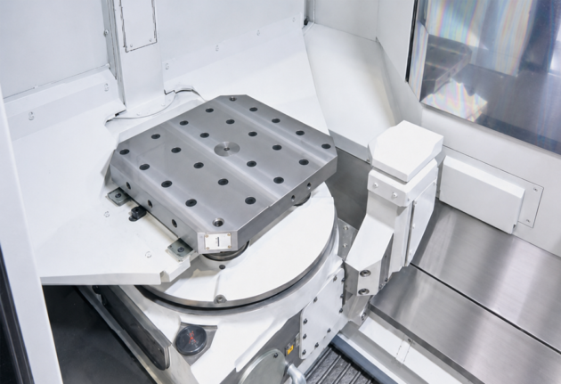

The MB-5000HII is a high-speed, thermally stable horizontal machining center that offers quick acceleration, short tool changes, and high power to improve productivity.
MB 5000 HII Interior 1500x843
SHOW MACHINE SPECS
The Okuma MB-5000HII machine tool at IMTS 2026 features the following specifications, options, and accessories:
CAPACITY/TRAVEL
Max. Machining Dia./Height Ø31.5"/39.4"
X/Y/Z Travel 29.9"/29.9"/31.9"
B-Axis 0.001° Indexing/Full Contouring
MAIN SPINDLE
Max. RPM 15,000 RPM
Spindle Tool Shank CAT40 BIG-PLUS
APC
APC Type Tower APC
PALLET
Pallet Size 19.7" × 19.7"
Pallet Surface 24×5/8-11 Tapped Holes
ATC
Tool Capacity 48 Tool Disc
Max. Tool Length/Weight 20.1"/26.4 lb.
MOTORS
Main Spindle 35 hp
MACHINE SIZE
W/D/H 100" × 221" × 114"
Weight 30,800 lb.

Making its Americas debut at IMTS 2026, the GENOS M4000H-e is a high-speed, thermally stable horizontal machining center that offers quick acceleration, short tool changes, and high power to improve productivity. Part of the Okuma Affordable Excellence line, this machine allows fast machining of aluminum and powerful cutting of steel.
MA 4000 H skeleton thumbnail
SHOW MACHINE SPECS
The Okuma MA-4000H machine tool at IMTS 2026 features the following specifications, options, and accessories:
CAPACITY/TRAVEL
Max. Machining Dia./Height Ø23.6"/35.4"
X/Y/Z Travel 22.0"/22.0"/24.6"
MAIN SPINDLE
Max. RPM 15,000 RPM
APC
APC Type 2 Pallet Rotary APC
PALLET
Pallet Size 15.7" × 15.7"
ATC
Tool Capacity 64 Tools Chain
Max. Tool Length/Weight 11.81"/22 lb.
MOTORS
Main Spindle 35 hp
MACHINE SIZE
W/D/H 95.3" x 185.0" x 104.3"
Weight 21,120 lb
