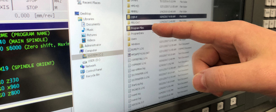

Many of us like to take a very hands-on approach when it comes to using the controller. It just feels natural to put a finger directly on the screen and move things around. Plus, many folks know their procedures like the back of their hands, and can breeze through a few fingertip touches very quickly. However, this can be dangerous because small icons or line items can be difficult to manipulate accurately, and the chances of doing something unintended are high. There can be a tendency to do what we call “fat fingering a file”, where we accidentally move something to an unknown destination, and then the file is lost and can be difficult to recover.

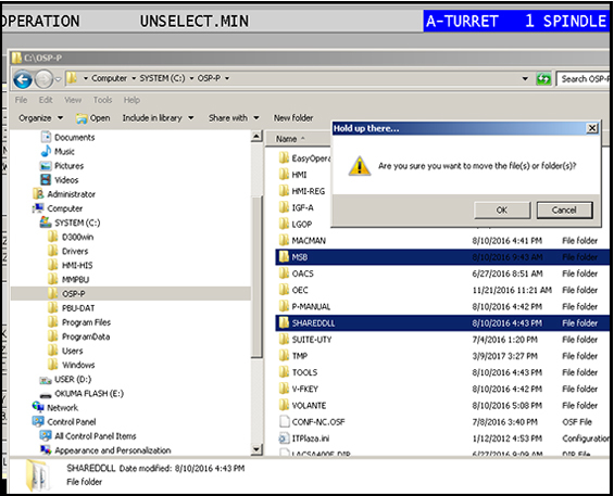

The Fat Finger Prevent machine tool app was created in response to real-world Okuma user experiences. It’s not uncommon for us to receive service calls regarding down machines due to fat fingered files. The Fat Finger Prevent app eliminates the possibility of accidentally moving important files or folders. By prompting the user for confirmation before any move operation is completed, costly downtime can be prevented.

But the best solution by far is to prevent fat fingering from happening altogether. Install our new app and you’ll see a confirmation window come up every time something is about to be moved. I encourage OSP control users to download this app. It’s so much better to take a few minutes to put this safety measure in place, and it might save you from a very uncomfortable situation in the future.
