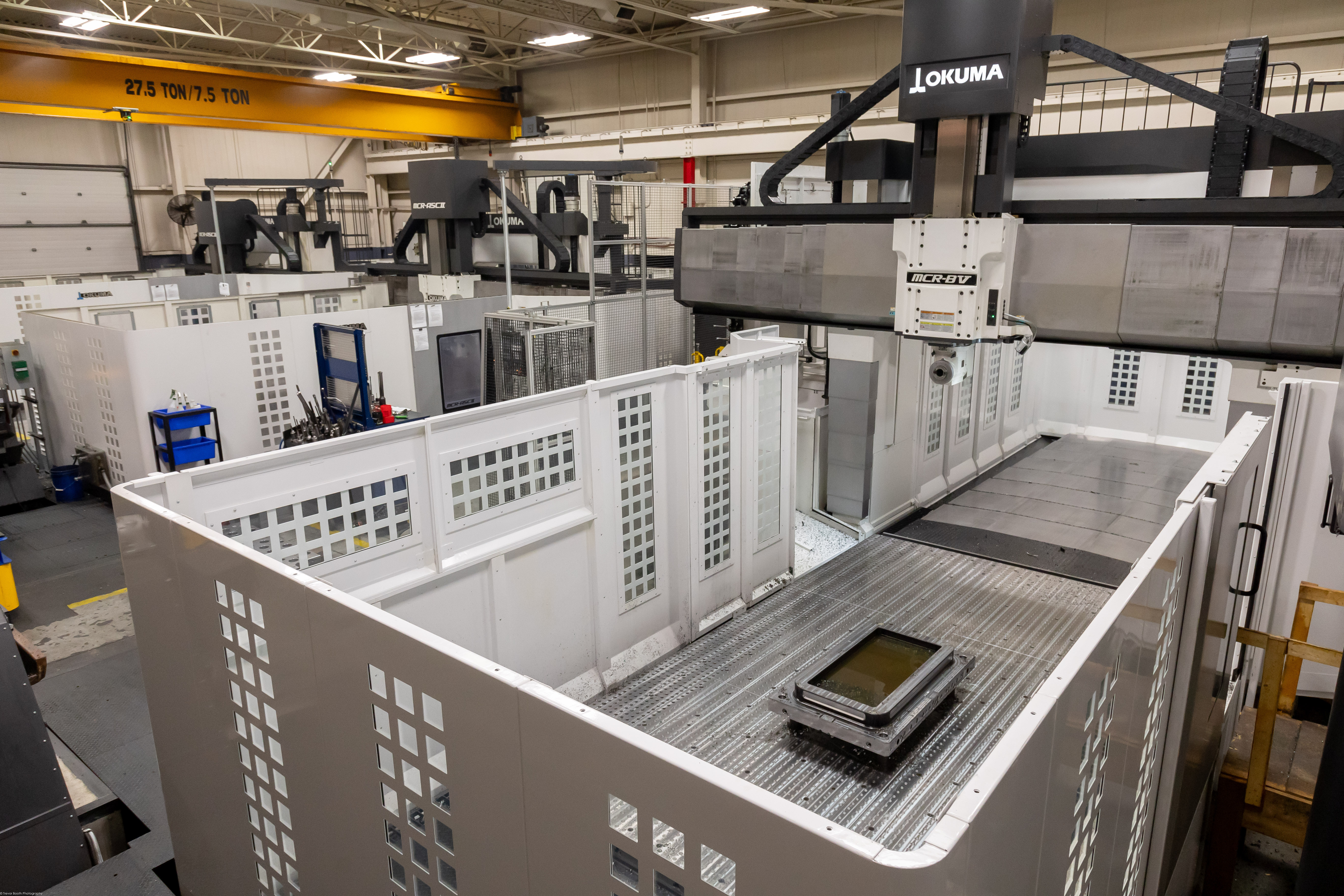

Investing in a third double column made perfect sense. Resource planning, business projections, and cost-benefit analyses at the beginning of 2025 showed Bendig, Caron, and the Cavalier Tool team that another Okuma double column, the MCR-BV this time, would be a lot more than just an extra spindle. On paper, it took weeks off orders, opened up time on other machines, and enabled more complex toolpaths. In theory, it handled parts up to 196 inches long and supported up to 35 tonnes of material. But before any contract was signed, Bendig wanted to see how the MCR-BV performed in person.
Windsor, Ontario, and Houston, Texas, are 1,313 miles from each other, but test cuts came together quickly at Hartwig (Houston), a long-time Okuma distributor with the MCR-BV on its showroom floor. Materials were shipped. Tools were in place. The machine was booked, ready, and waiting.
“We needed a bunch of horsepower and rigidity for heavy drilling. A lot of people like to say their machine tools are rigid, but we like to see how much cutting we can actually do. We got a three-inch drill and a six-inch facemill in there. We cut straight and cut on an angled head. This machine threw chips everywhere,” says Bendig, impressed by torque and speed. “It was faster than we thought it’d be. It did everything great. All eyes were on us and the machine during the test cut. No one in the room had ever seen their tool run like this.” That’s because no one makes double column machining centers like Okuma.
Bendig finalized the deal with an assured confidence, which added the following strengths and differentiators to Cavalier Tool’s operations:
  • Table sizes up to 3,000 mm x 5,000 mm and column spacing of 3,150 mm
  • True 5-face indexing and continuous 5-axis contouring for roughing, drilling, semi-finishing, and finishing — all without refixturing
  • A 43-kW integral motor and 6,000-rpm spindle that delivers up to 1,406 Nm of torque
  • Multitasking attachment heads, including an extension head, right angle head, and universal 5-axis head
  • 180-pocket tool magazine to increase flexibility, reduce non-cutting time, and simplify job changeovers
  • The ability to hold 73,000 lbs. when cutting oversized blocks, tall/wide molds, or performing aggressive milling
The initial costs of the MCR-BV were significant, but the returns quickly justified its value. Production volumes are at an all-time high on this double column and their two MCR-A5CIIs. The average reduction in cycle times on all three double columns (compared to current equipment) is 30-40% — even up to 80% on the right parts. Customers get access to perfect parts without compromises in lead time or quality and without design limitations.
