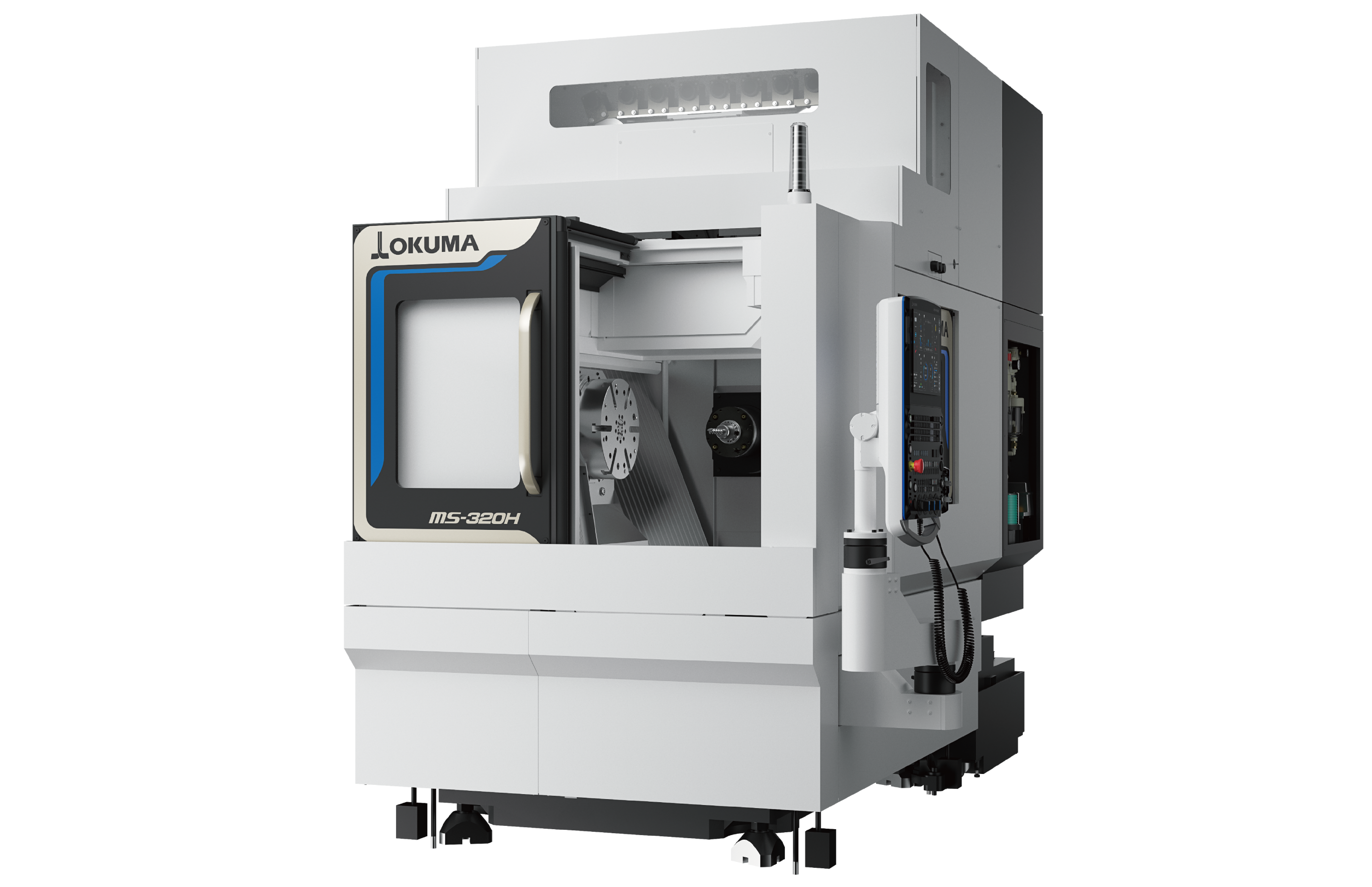

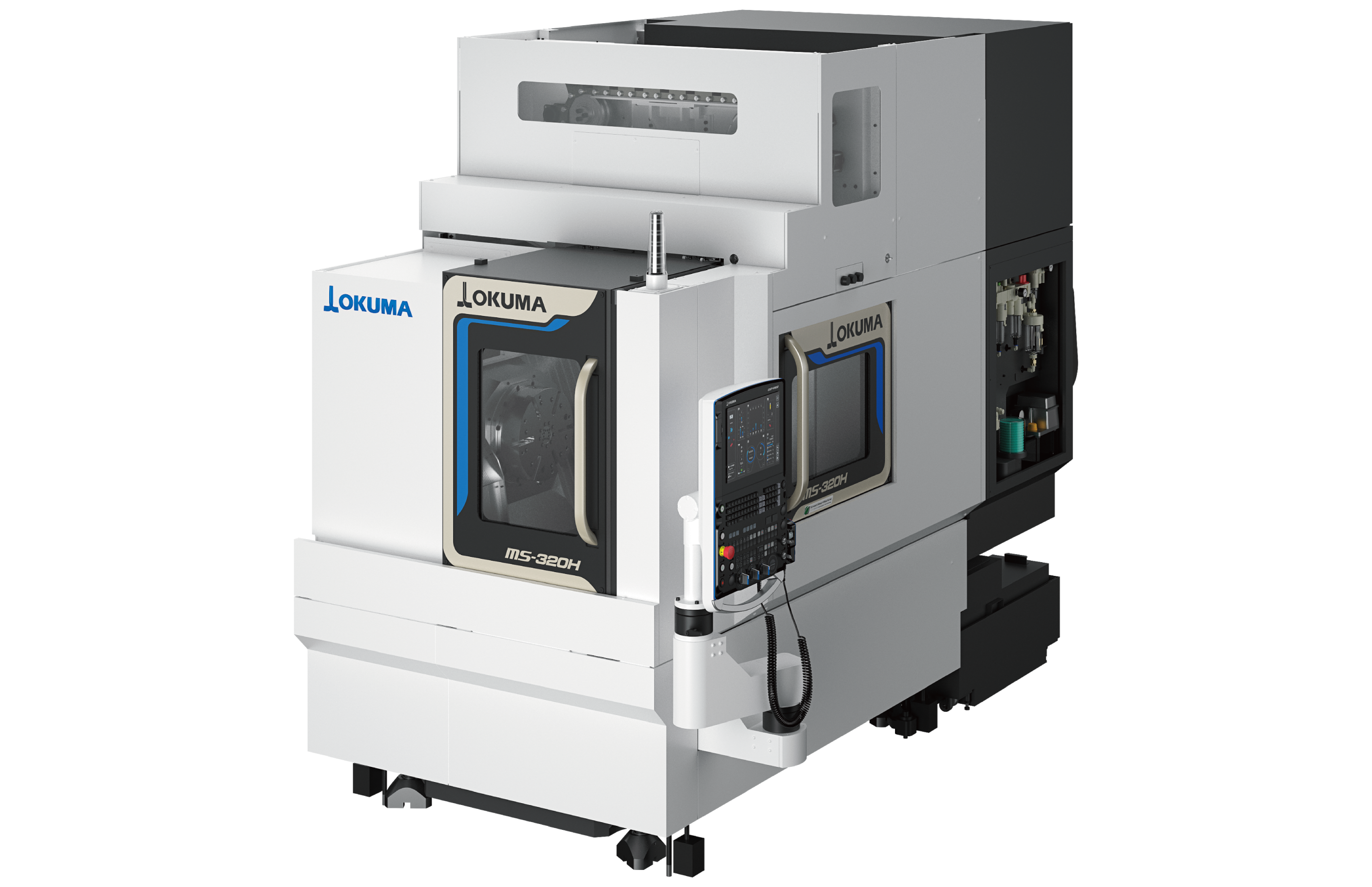

The Okuma MS-320H is a compact 4-axis horizontal machining center designed to support efficient automated production. Standard-equipped with an 8-port hydraulic through-table system, the machine simplifies the integration of automated clamping systems and helps streamline manufacturing operations.
Engineered for high-speed performance, the MS-320H offers rapid feed rates up to 60 m/min and 1G axis acceleration, reducing cycle times and improving overall productivity. A powerful spindle delivers excellent cutting performance across a wide range of materials and applications.
The MS-320H is well-suited for advanced manufacturing industries, including electric vehicle (EV) and semiconductor production.
The machine is equipped with Okuma’s OSP-P500 CNC control, providing intuitive operation and simplified programming.
Learn more about Machining Centers.
Max Machining Volumein9.84 x 9.84 x 22.44
Rotary Pallet Sizeinø12.59
Spindle Speedmin⁻&sup1 (rpm)15,000
Spindle Power <15%ED/25%ED/cont>hp33/20/15
Rapid TraverseipmX, Y: 1,969 | Z: 2,362
Magazine Capacity 10 [24]
Max Machining Volumemm250 x 250 x 570
Rotary Pallet Sizemmø320
Spindle Power <15%ED/25%ED/cont>kW25/15/11
Rapid Traversem/minX, Y: 50 | Z: 60
