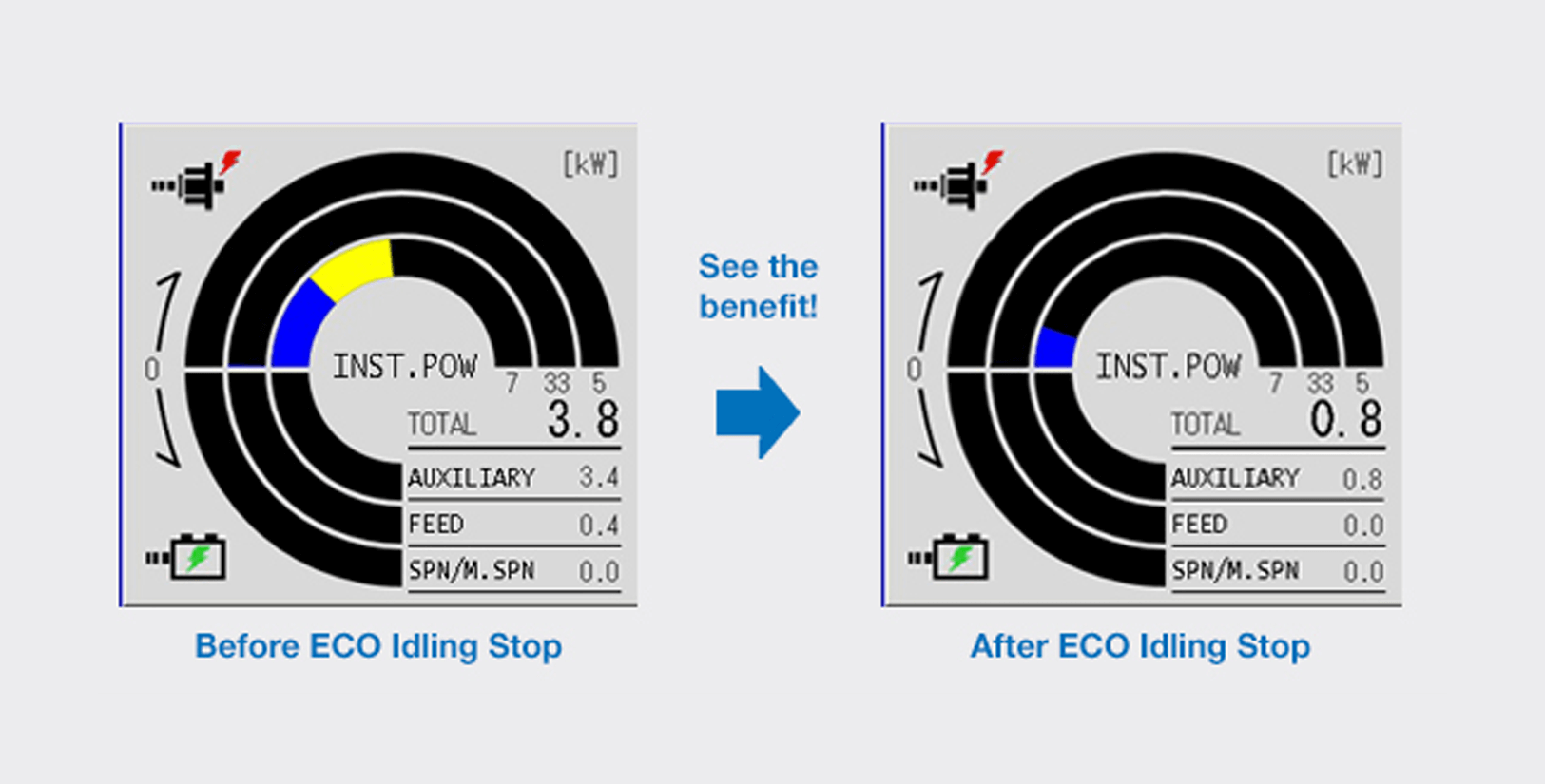

ECO Idling Stop carefully stops peripheral equipment, and the benefits increase with longer machining preparation times. The result is dramatically decreased power consumption when the machine tool is not cutting, and power can even be reduced while cutting with the optional ECO Hydraulics. See Figure 2 for an example showing a 74% decrease in non-cutting power consumption that can be achieved in just one month. Figure 2: Example of the decreased power consumption that ECO Idling Stop can achieve in just one month. (Calculated from actual power consumption measurements. Power consumption will differ depending on machine specifications and usage conditions.)

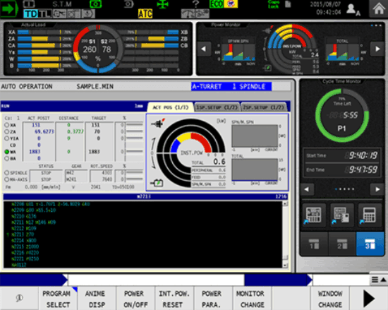

The ECO Power Monitor allows you to see how much energy is being saved – right on the machine tool’s display (See Figure 3). Power consumption is shown for spindles, feed axes and peripheral equipment.

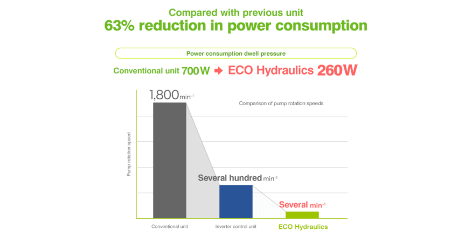

This optional feature gives you the best of both worlds: accurate control, at a very low rotation speed. ECO Hydraulics minimizes unnecessary pump rotation during dwell pressure applications. Pump rotation is optimized to match operating status by combining the servo control technology on the machine tool with high-efficiency hydraulic pumps. The result is a significant reduction in power consumption. In the example below we see a savings of 63% (See Figure 5). Figure 5: An example of 63% reduction in power consumption achieved by using ECO Hydraulics.

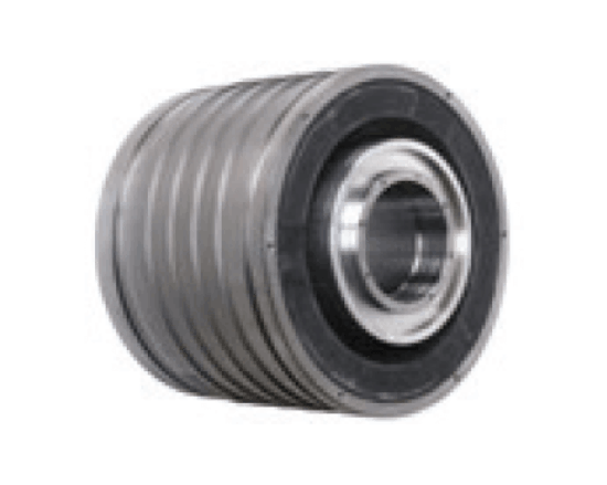

Many of Okuma’s CNC machines are equipped with the company’s PREX motor, which in 2009 won the Superior Energy-Saving Machine Award sponsored by the Japan Machinery Federation.PREX motors are built-in reluctance motors incorporated in the many spindles used in Okuma machine tools. Numerous slits in the rotor make generation of reluctance power more efficient (See Figure 6). This unique rotor structure has a small amount of interpolated permanent magnets to increase performance. The PREX motor is more efficient than induction motors, which were the main power source of spindles in the past, and high torque in typical turning ranges raises the system efficiency by 4-9%.
PREX motors are also compact, with low mass in the rotating section that reduces inertial mass by 47%. This makes acceleration and deceleration highly responsive. The combination of all these features reduces energy consumption by 5-13%.
