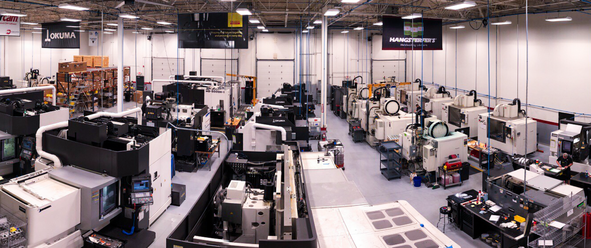

Lined with championship trophies, DSM Precision Manufacturing’s 155,000-square-foot facility in Brownsburg, Indiana, is a strategic setting for current production activities and strategies. It’s where DSM’s 60/40 business split of motorsports parts and aerospace and defense components, respectively, are prototyped and perfected to scale. Like dragsters from the starting line to the finish line, DSM Precision Manufacturing completes entire machining processes with pure accuracy and speed in one go, turning and milling raw stock into final assemblies in-house.
The space holds 26 Okuma machine tools out of an enviable 41-machine-tool lineup that includes the Okuma MCR-BIII double column machining center, two MU-6300V-L 5-axis machining centers, six GENOS M560-V vertical machining centers, and two GENOS M560V-5AX vertical machining centers, just to name a few. Additionally, thousands of inserts, grades, and other Sandvik Coromant tools exclusively fill the shelves, waiting to thread, mill, and drill.

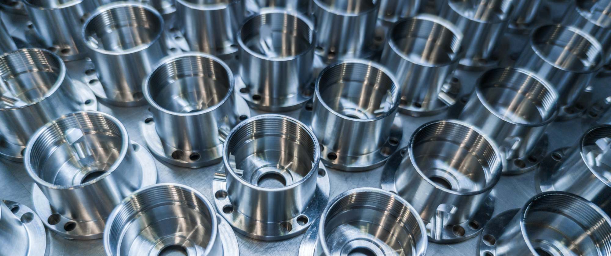

Microscopic, medium-sized, and larger-than-life components — DSM Precision Manufacturing’s strengths in part production have no ceilings and consolidate supply chains for every customer. Using Okuma’s MCR-BIII and Sandvik tooling, they are able to produce:
  • an 800-pound nitro block forging into a 146-pound part
  • an 11,000-horsepower engine block in 38 hours
  • 100 confidential parts less than 0.100" in diameter to exact specs
Note that some of these parts are seen on SportsCenter each weekend. Some are 30,000+ feet in the sky. Some make modern life easier. All meet strict quality standards, including AS9100 and ITAR.
