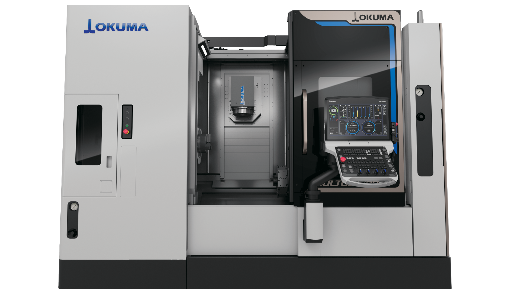

  • Okuma OSP-P500 CNC Control
  • Lower Turret - Minimized cycle time
  • Wide (240°) B-Axis Swing - highly accurate 5-axis machining
  • OSP Suite - Pre-loaded with the apps you need
  • Optional Sub Spindle - Even greater flexibility and productivity
  • Operator-Friendly ATC - front access to tools
Our MULTUS U2000, equipped with B-axis head, is a multitasking machine with an automatic tool changer and optional sub-spindle and lower turret. This 8-inch chuck class machine has a broad scope of machining functions and is the embodiment of power, speed, and process flexibility. With this machine, you can complete the work in one setup and with tools to spare in the ATC. The MULTUS U2000 has a 240° B-axis range with a 12,000 rpm H1-milling spindle with dual function (L/M). The MULTUS U2000 has 80 tools available via the ATC, and the H1-turret has a 0.001-degree B-axis, provided by a traveling-column-type Y-axis feed, enabling powerful Y-axis machining over a range of 8.66 inches. Both the left and right (optional) spindles are equipped with a full-contouring C-axis, and the optional lower turret provides additional capability for increased throughput and process balance. Familiar programming methods from both lathe and machining center disciplines blend easily thanks to our OSP-P500 control, making advanced functions such as “Collision Avoidance System” standard.
