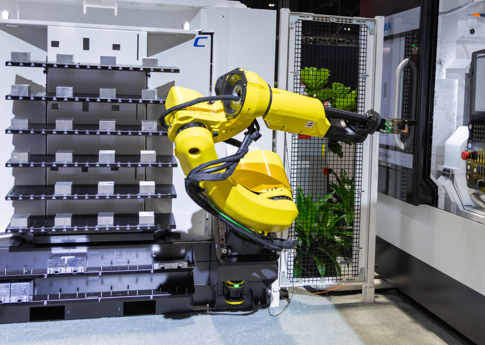

Okuma Robot Loader – Machining Center
Orl mc
Specializing in mixed-part, low-volume automation, the ORL-MC features a three-sided rotating station. Parallel loading and unloading of workpieces for multiple operations can be performed with automatic changeover.
  • Handles up to 288 parts.
  • Set up in less than ten conversational steps, speeding deployment and minimizing training.
  • Only requires 9 feet of working floor space.
  • Allows for continued, unmanned production throughout the day and night.
  • Pre-engineered, effective, and affordable automation option starting under $100k.
