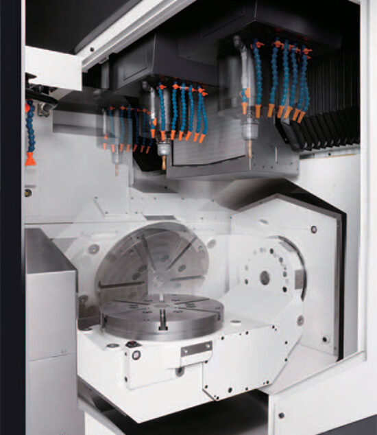

Vertical machines are typically used to reach the three traditional axes, but over the years, products like rotary tables and tilt-rotary trunnions have been added to create movement on an additional two rotary axes (chosen from the A, B and C axes) resulting in a 3+2 axes operation. This process is also referred to as positional five-axis machining because the fourth and fifth rotary axes keep the part in a fixed orientation, then typical 3 Axis machining can be carried out, instead of moving it continuously during the machining process (as in the simultaneous 5-Axis process – see below).
The main advantage to adding a 3+2 setup to your current vertical machine is that it allows a workpiece to be machined from all sides. This reduces the need for additional set ups thereby lowering the cycle time and reducing costs. 3+2 can also use a shorter, more rigid cutting tool than a regular three-axis machining, resulting in greater dimensional stability.

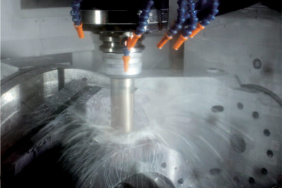

5-Axis machines, also known as simultaneous 5-Axis, move the cutting tool on the X, Y and Z axes and rotate the A, B and C axes to maintain continuous contact between the tool and work piece, unlike 3+2 operations, where the part is in a fixed orientation.
Why swap out your rotary table for an integrated 5-Axis machine?
Think of it this way: as technology progresses, it makes our lives easier. For example, as smartphone apps developed, they enhanced our everyday processes. They’ve made things like directions, high-quality photography and the internet user-friendly and simple. The latest simultaneous 5-Axis machines are not much different. As 5-Axis technology continues to grow and develop, it makes the 5-Axis process easier to navigate. A designated 5-Axis machine is built not only to handle, but constantly improve upon the 5-Axis process. They’re also less complicated to operate because the “bells and whistles” are built in.
One of the biggest advantages to using a 5-Axis machine is the ability to create complex work pieces and accurate components with less time, money and skilled labor.
With 5-Axis machines you can use standard length tools, which increases tool rigidity, leads to higher feed rates and longer tool life, helping you cut costs in tool turnover and insert replacement. Your machine’s accuracy is greatly improved through Okuma’s 5-Axis autotuning, giving you a “done in one” set up process. Accuracy also means less scrap, so your shop produces less waste. That minimized set up also increases speed and relies much less heavily on human interreference, cutting out the dire need for skilled individuals. A major plus: 5-Axis machines give your shop a competitive edge and show the consumer you’re able to do more, accurately, at a quicker pace.
