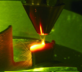

 As we evolve beyond subtractive-only machining and into the world of additive, there are new safety considerations and procedures that must be learned and implemented in shops. Okuma’s new LASER EX machines combine subtractive and additive functionalities all within a single machine. The LASER EX machines are a combination of a standard Okuma 5-axis machining center (MU series) or 5-axis multitasking machine (MULTUS series) and incorporates a Trumpf laser for laser metal deposition. In addition to standard laser safety considerations provided by Trumpf, Okuma has created this checklist to ensure that our customers have the proper safety programs in place as they upgrade to the latest technology.
