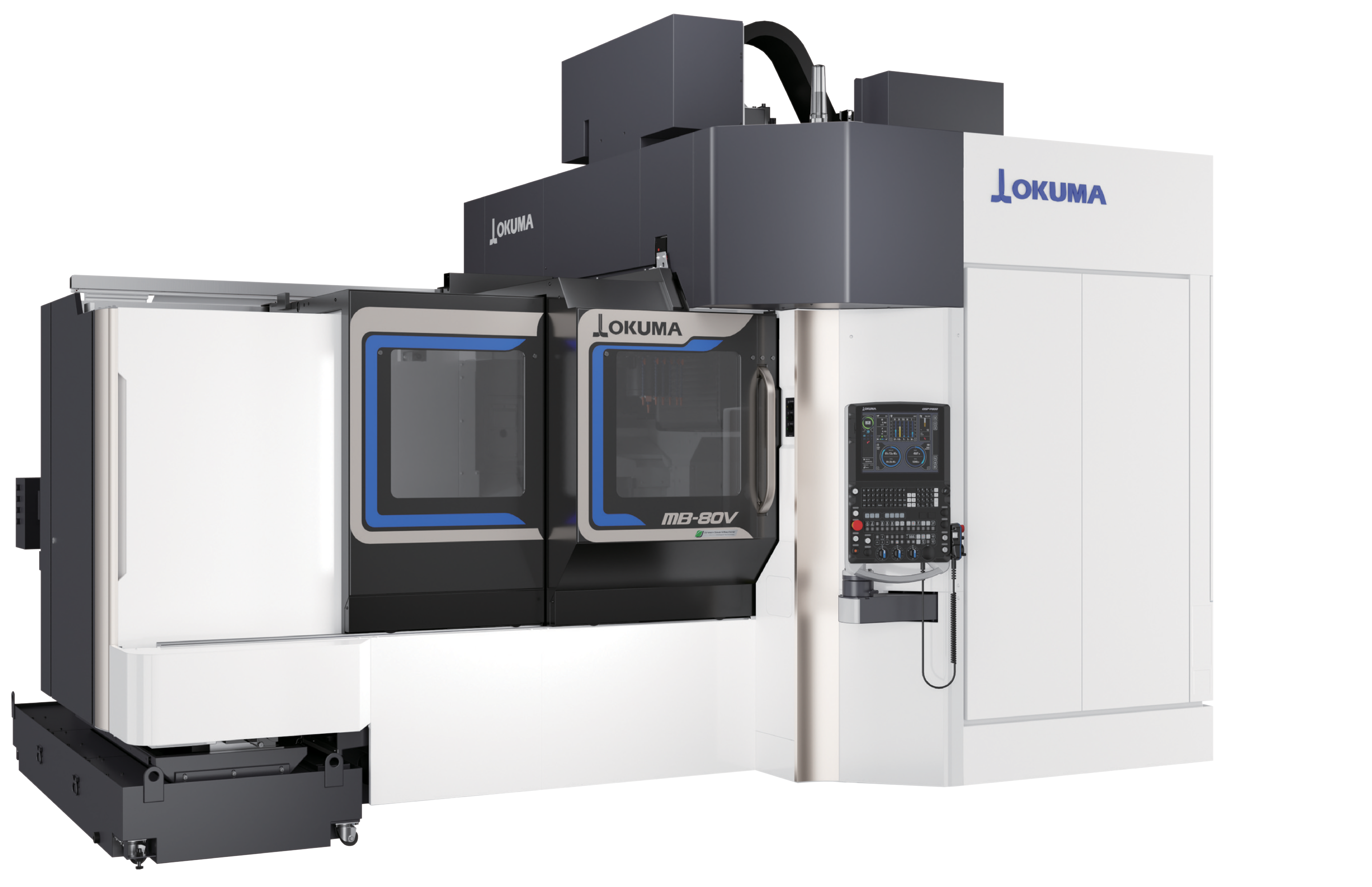

MB 80 V Closed 5790x3743
MB-80V
  • Compact Footprint - For floor space efficiency
  • OSP P500 Control sithe OSP Suite - Pre-loaded with the apps you need
  • Generous Work Envelope - Accommodates larger workpieces
  • Two Spindle Options - CAT40 BIG-PLUS® or CAT50 BIG-PLUS®
Preventive Maintenance Insights
Watch our machining center preventive maintenance video for helpful tips.
The MB-80V is a high-accuracy bridge mill that is ideal for machining large parts. This machine delivers cutting accuracy, high speeds, and powerful, heavy-duty cutting. With maximum quality and productivity, the MB-80V is well-suited for machining large components such as those used in semiconductor manufacturing equipment and automobile die/molds. Okuma’s Thermo-Friendly Concept ensures accuracy, and efficient chip handling means reduced maintenance. Reduced cycle times are achieved with the MB-80V’s powerful spindle and CNC controlled Hyper Surface technology. The intelligent design of this machine delivers maximum table size and productivity in a minimum footprint.
Learn more about Machining Centers.
Max Machining Volumein62.99 x 41.34 x 23.62
Table Sizein62.99 x 31.50
Spindle Speedmin⁻&sup115,000 [20,000; 12,000]
Spindle Motor Powerhp35/25 [40/30, 43/35, 44/35]
Rapid Traverseipm1,654/1,260
Magazine Capacity 32 [48, 64]
Max Machining Volumemm1,600 x 1,050 x 600
Table Sizemm1,600 x 800
Spindle Motor PowerkW26/18.5 [30/22, 33/26]
Rapid Traversem/min42/32
