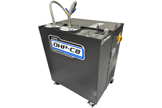

OHP C8 v2
High Pressure Coolant
  • 8 GPM (gallons per minute) variable flow rate*
  • 1000 PSI programmable pressure capability
  • (2) 7x32” 5‑micron quick‑change filter bags
  • 50‑gallon vertical reservoir
  • Built‑in feed/supply pump
  • 208/230V standard; 480V available
  • Compatible with water‑based coolants or suitable oils
  • Clear English-language PLC notifications
  • Dirty filter alarm
  • 2‑year parts warranty
  • Compact, Shop‑Friendly Footprint:
  • 36" L × 28" W × 42" H — Weight: 850 lbs
*Fixed flow pump option is also available
The Okuma High-Pressure Coolant System (OHP Series) is engineered to deliver powerful, reliable coolant performance for demanding machining environments. Designed specifically for seamless integration with Okuma machine tools, the OHP enhances chip evacuation, extends tool life, improves surface finishes, and drives greater productivity across your shop floor.
As part of Okuma’s growing line of integrated peripheral solutions, the OHP Series supports high-precision machining in multi-axis lathes, multi-function machines, and machining centers. Its robust construction and advanced filtration system ensure consistent coolant cleanliness and dependable operation, even in high-pressure, high-performance applications.
Built for Performance
The OHP Series delivers up to 8 GPM flow capacity and 1000 PSI pressure capability, providing the power required for today’s aggressive cutting strategies. Dual 7” x 32”, 5-micron quick-change filter bags maintain exceptional coolant quality, while a 50-gallon vertical reservoir and integrated feed/supply pump support long, uninterrupted machining cycles.
Designed for Versatility & Ease of Use
Compatible with water-based coolants and suitable oils, the OHP adapts easily to a wide range of shop environments and applications. Operators benefit from intuitive, plain-English PLC messaging for simplified monitoring and maintenance. A built-in dirty filter alarm alerts users when service is required, helping protect tooling and maintain consistent performance.
Compatible Okuma Products:
Additional Options:
  • Integrated Washdown
    Includes hose/nozzle, magnetic on/off control, and magnetic nozzle holder
  • Abrasive Duty Upgrade
    Recommended when machining abrasive materials
