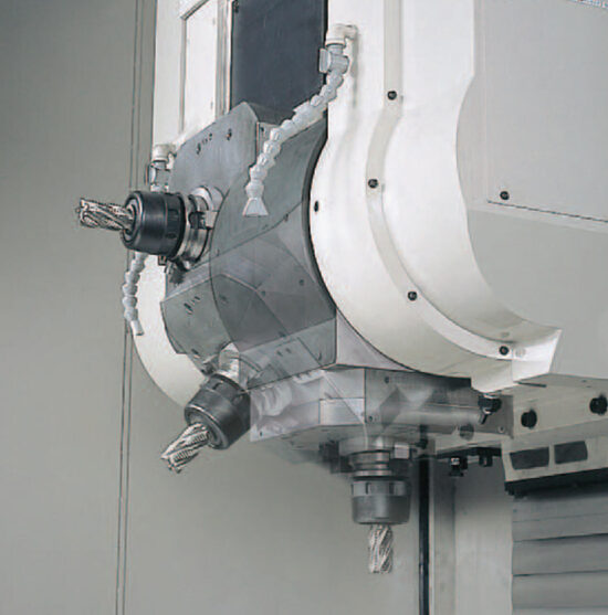

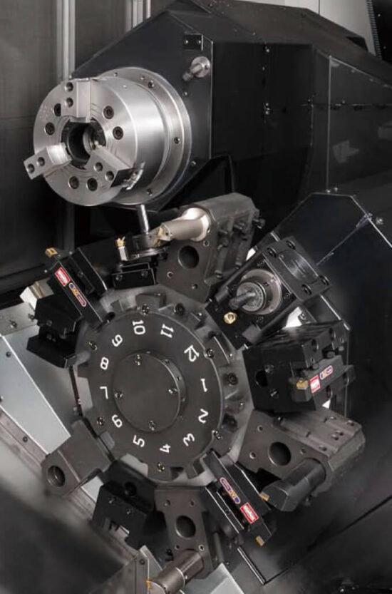

Multitasking machines combine the functionality of two or more traditional standalone machine tools to form one “super” machine. In their most common form, multitasking machines combine one or two lathes with a machining center. However, in recent years additional capabilities (grinding, gear cutting, even Laser Hybrid) have started to integrate as well. The beauty behind multitasking machines is that there are a variety of configurations available, so you can invest in what makes sense for your shop.

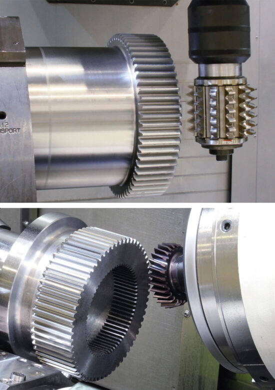

Okuma multitasking skivingandhobbing ff
Hobbing (TOP IMAGE), Skiving OD/ID spines (BOTTOM IMAGE)

  • Hobbing
  • Skiving

For example, our MULTUS U Series multitasking machines come equipped with an automatic tool changer, sub-spindle, and lower turret. Because of its ability to use different cutting processes on the same part, it can create contours, perform turning, milling, skiving, Turn-Cut, and gaging tasks all in one setup.

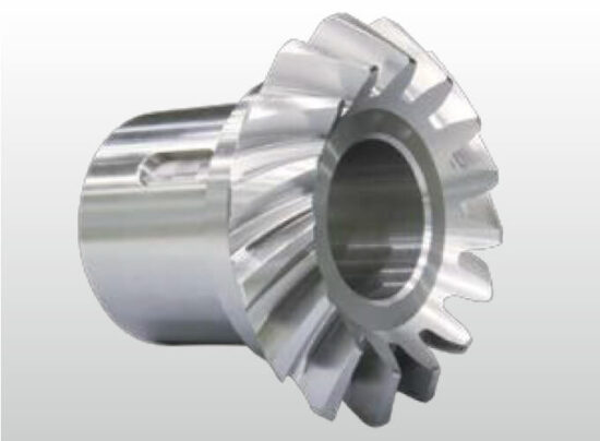

Spiral Bevel Gear (done on MULTUS BII Series)

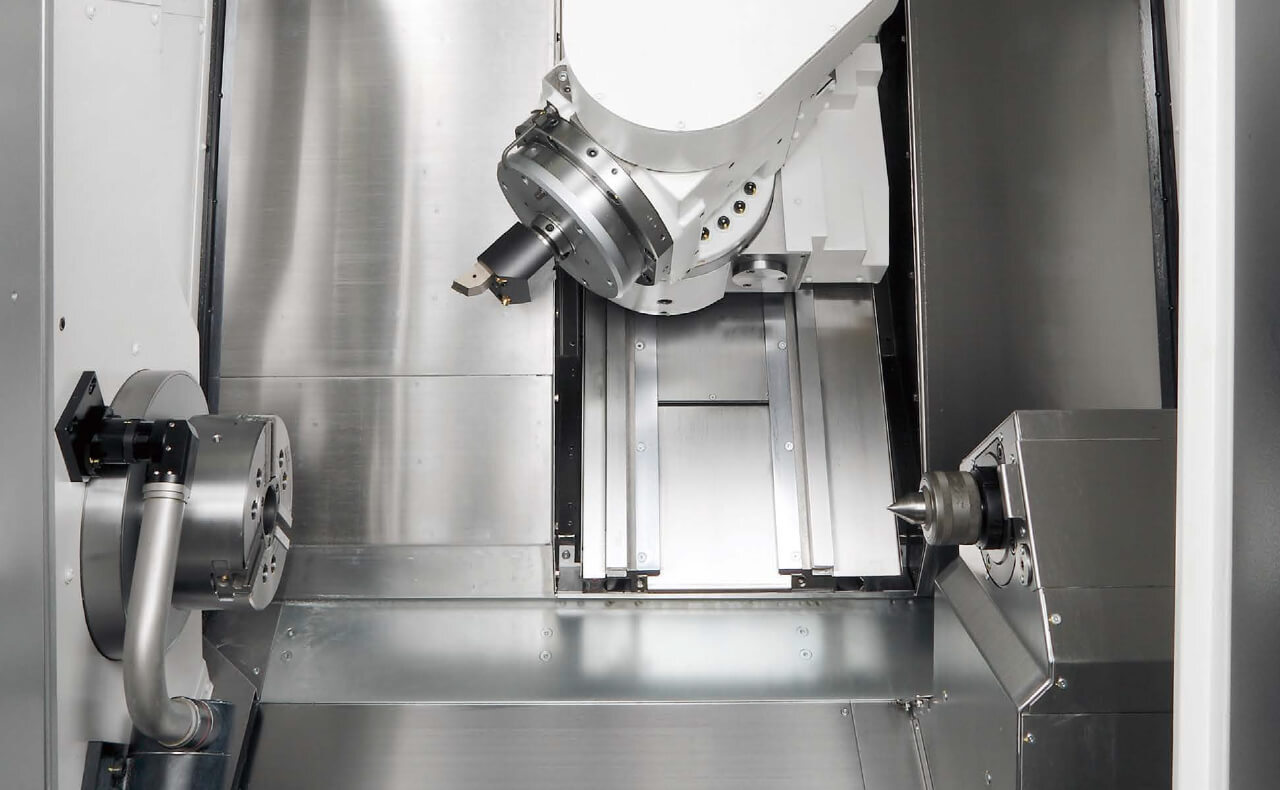

One thing we do notice is that the B-axis on a multitasking machine can throw some operators a curveball, and expensive machines, in general, can be intimidating to use. That’s why Okuma helps protect your investment with the Collision Avoidance System (CAS), as well as other standard tools, to help minimize any potential crashes.

Specific beneficial applications include the Collision Avoidance System (CAS), a lifesaving tool for avoiding costly mistakes, and the built-in quick-change functionality of the ATC, which is an incredible time-saver. In addition, if your tools are in the magazine and you do a changeover, you can change out the chuck jaws in which you’d get a quick-change chuck: the jaws take two minutes to changeover, select the program and then cycle start. You still must step through the program, but your change time goes to a couple of minutes, and it makes a huge difference when you want to run a lot of different parts.
